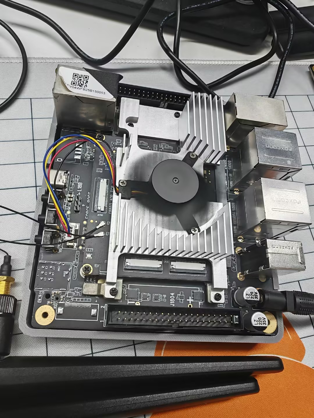

犀牛派X1上部署LocalSend实操指南

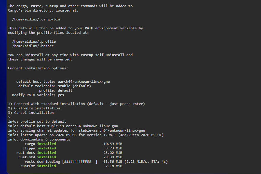

第二步:安装 Rust
curl --proto '=https' --tlsv1.2 -sSf https://sh.rustup.rs | sh
  • 弹出选项输入 1,默认安装
  • 安装完成加载环境变量
source "$HOME/.cargo/env"

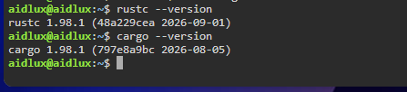

校验:
rustc --version
cargo --version

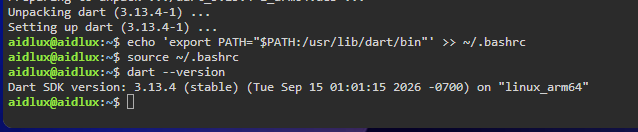

第三步:安装 Dart,然后安装 FVM
FVM是dart的全局包,所以先装dart:
# 添加dart源
sudo apt install -y apt-transport-https
wget -qO- https://dl-ssl.google.com/linux/linux_signing_key.pub | sudo gpg --yes --dearmor -o /usr/share/keyrings/dart.gpg
#科学上网
echo 'deb [signed-by=/usr/share/keyrings/dart.gpg] https://storage.googleapis.com/download.dartlang.org/linux/debian stable main' | sudo tee /etc/apt/sources.list.d/dart_stable.list
sudo apt install dart
配置dart环境变量
echo 'export PATH="$PATH:/usr/lib/dart/bin"' >> ~/.bashrc
source ~/.bashrc

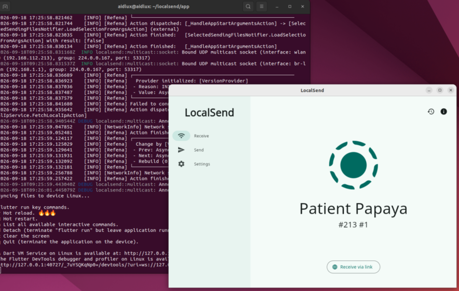

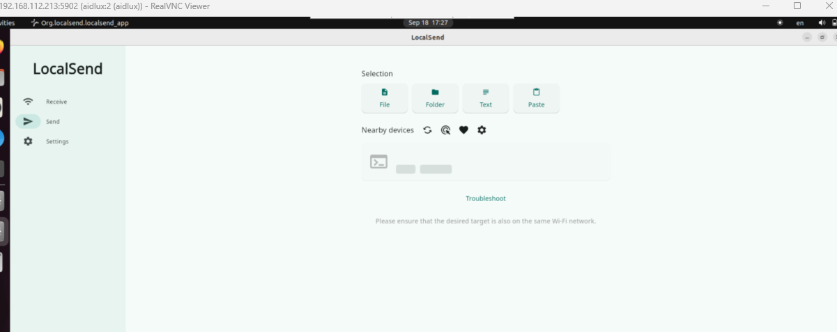

fvm flutter run -d linux
会编译Rust核心库 + Flutter UI,启动LocalSend桌面GUI。
